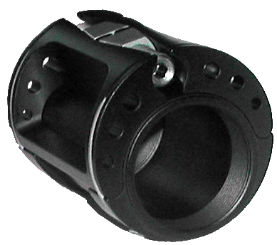

    por si os interesa un eccentric y bicis a medida, solo que hay que ir a california
    Custom Bicycles from Rodriguez - R+E Cycles - Home of Rodriguez Custom bikes, Women's Bicycles, Tandem Bicycles, and Accessories. rodriguez custom bicycles women's bicycles tandem bicycles bikes BIKES BICYCLES accessories
    http://www.bushnelltandems.com/
    Bicycle Products That We Make
    The Bushnell Eccentric Bottom Bracket
    The Bushnell Eccentric is a bicycle part for adjusting chain tension on tandem and single speed bicycles. We now manufacture about 2,000 per year. We make them in batches of 500.
    As you can see from the picture, it consists of many machined parts. We were able to develop techniques for manufacturing the product efficiently right here in Seattle.
    Many bicycle manufacturers use our product as a standard specification. We even get orders from companies in Taiwan and Europe.
    If you have a part that you need to have produced in quantities, but you're not ready for the overseas commitments and headaches, why not give us a try? Machine Capabilities List
    The 2007
    Bushnell Eccentric[​IMG] The Bushnell eccentric:
    Advanced design, light and easy to use.
    General Specifications:
    • Weight - 140 grams
    • Construction materials - aluminum and stainless steel
    • Diameter of part - 2.118 inches
    • Can be used in BB shells from 2.120 ~ 2.125 inches
    • Ideal bottom bracket shell width - 66mm
    • Manufactured in the U.S.A.
    • Download installation instructions
    Good News for Co-motion and Cannondale owners!!
    The Bushnell eccentric is now available directly from us to Co-motion and Cannondale owners at a competetive upgrade price of just $120. We've had enough requests about it over the last few years that I did some research and discovered that these brands are compatible with our eccentric! Contact R+E Cycles for ordering.
    Read a history of the Bushnell eccentric. Look at a photographic evolution of the Bushnell eccentric. If you are a frame builder, and would like to order in quantities of 20 or more at a time, you can email Amber directly about setting up an OEM account.

    El Bushnell no sirve para cajas de pedalier estándar. Es para las cajas excéntricas (como las que llevan los tándem alante y algunas bicis como ciertas Cannondale o el cuadro Santa Cruz Chameleon, entre muchos otros menos conocidos).
    Bueno mira Koyabro, si estás realmente interesado podemos ir haciendo un juego de planos para que se lo lleves a tu tornero. Como prototipo, que luego se puede ir mejorando. Lo mismo hay más gente interesada en esto por aquí.
