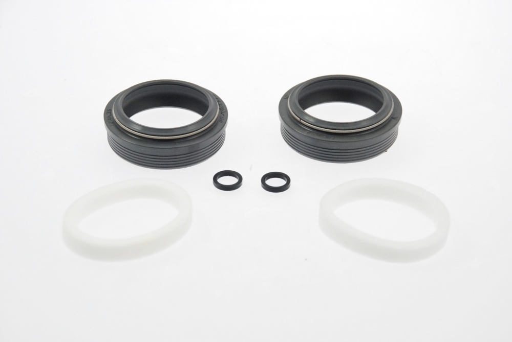

    Despues estan los Enduro, muy conocidos, pero yo nunca los he usado, yo lo que se es que se usan en las horquillas con desgaste o tocadas porque sellan mejor pero dicen que tambien son de baja friccion.
    Caracteristicas:
    Enduro Fork Seals Kits for Upgraded Performance and Longevity:
Polyurethane dual-lip seals keep dirt out and the oil in.
    Enduro wipers seal better, move faster, are slicker, last longer, and run quieter than stock wipers.
    Available for most major brands and models of suspension forks at substantial savings and improvement over stock wipers.
    More sizes and applications available all of the time. We never stop designing and improving!
    Y aqui en ebay, creo yo, bien de precio.
    http://www.ebay.es/itm/ENDURO-Fork-...7?pt=LH_DefaultDomain_212&hash=item3ce3ff8d4f
    Y aqui un pelin mas caros y son mas basicos.
    http://www.bicimarket.com/Suspensio...Enduro-Retenes-para-Manitou-34-mm-p17526.html
