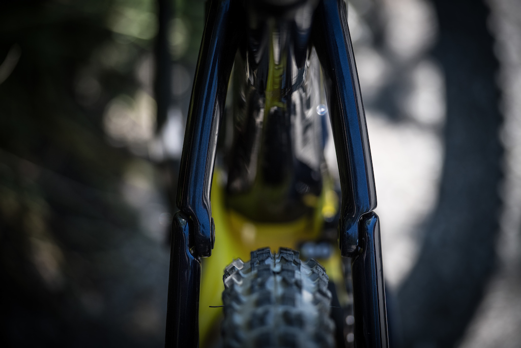

    Future Proofed From the Past - Tire clearance isn't an issue on the majority of contemporary all-mountain and enduro race bikes, but the Slayer has even more room to spare than most. It can easily fit 27.5 x 2.5'' rubber, but what if I said you could also run 26 x 3.0'' meat? What goes around comes around, and what's coming around soon is a new generation of wide 26'' rubber that supposedly comes close to matching the outer diameter of a wide-ish 27.5'' tire, thereby not messing up a bike's geometry. Rocky Mountain is not spec'ing any of their bikes with these tires, but they did have a set of 26 x 2.8'' Maxxis Minions on hand that were mounted up to wide Stan's 26'' rims. They looked odd, and a bit like old Nokian Gazzaloddis crossed with a tread pattern that actually works.
    [​IMG] There's room for those three-inch-wide Gazzaloddis that you've been refusing to throw out.
    To be clear, Rocky isn't pushing this but rather only responding to what they see coming down the road. The mention of 26'' x wide rubber is definitely worth a few good eye rolls, and I don't expect it to become overly popular, but Rocky Mountain is future-proofing their new Slayer just in case someone wanted to go the short and fat route. They're just another option.
